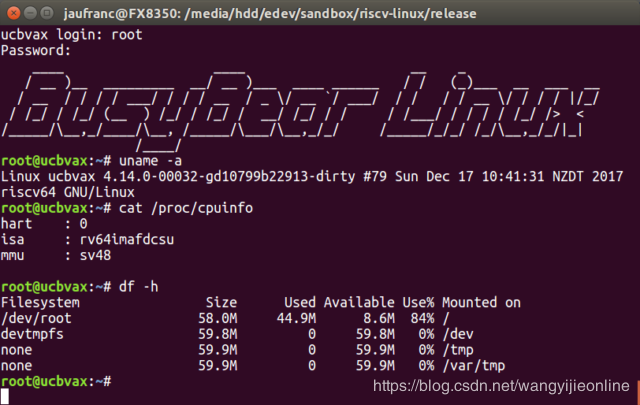

    We can login with root using password “busybear” without quote.
    1. ucbvax login: root
    2. Password:
    3.     ____                   ____                     __    _
    4.    / __ )__  _________  __/ __ )___  ____ ______   / /   (_)___  __  ___  __
    5.   / __  / / / / ___/ / / / __  / _ \/ __ `/ ___/  / /   / / __ \/ / / / |/_/
    6. / /_/ / /_/ (__  ) /_/ / /_/ /  __/ /_/ / /     / /___/ / / / / /_/ />  <
    7. /_____/\__,_/____/\__, /_____/\___/\__,_/_/     /_____/_/_/ /_/\__,_/_/|_|
    8.                  /____/
    9. root@ucbvax:~# uname -a
    10. Linux ucbvax 4.14.0-00032-gd10799b22913-dirty #79 Sun Dec 17 10:41:31 NZDT 2017 riscv64 GNU/Linux
    11. root@ucbvax:~# df -h
    12. Filesystem                Size      Used Available Use% Mounted on
    13. /dev/root                58.0M     44.9M      8.6M  84% /
    14. devtmpfs                 59.8M         0     59.8M   0% /dev
    15. none                     59.9M         0     59.9M   0% /tmp
    16. none                     59.9M         0     59.9M   0% /var/tmp
    17. root@ucbvax:~# cat /proc/cpuinfo

    Type halt to turn off Linux and QEMU:
    1. root@ucbvax:~# halt
    2. root@ucbvax:~# umount: devtmpfs busy - remounted read-only
    3. umount: can't remount /dev/root read-only
    4. The system is going down NOW!
    5. Sent SIGTERM to all processes
    6. Sent SIGKILL to all processes
    7. Requesting system halt
    8. [  410.790000] reboot: System halted
    9. Power off
