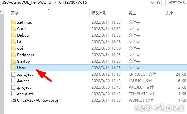

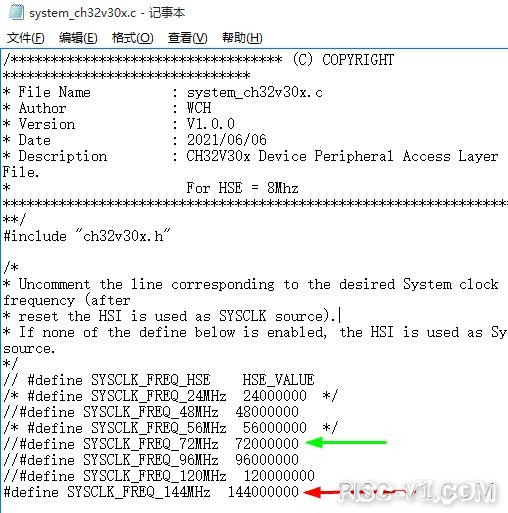

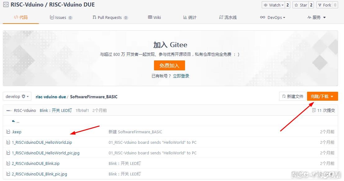

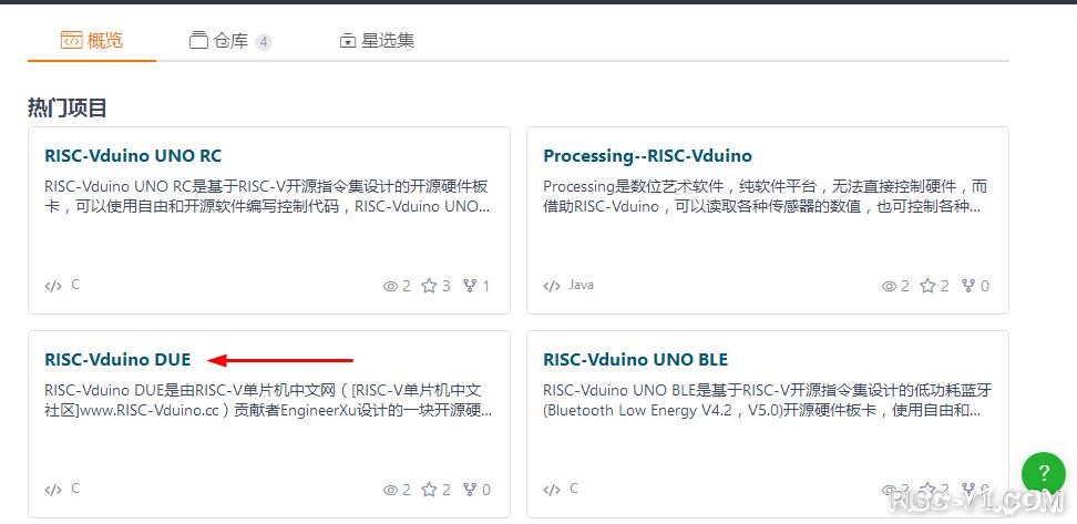

    在码云:https://gitee.com/risc-v-mcu-chinese-network  下载测试代码,找到工程文件,修改    system_ch32v30x.h 文件中的宏定义
    1
    2
    3
    4
    5
    2. * File Name          : system_ch32v30x.c
    3. * Author             : WCH
    5. * Date               : 2021/06/06
    6. * Description        : CH32V30x Device Peripheral Access Layer System Source File.
    7. *                      For HSE = 8Mhz
    8. *********************************************************************************/
    9. #include "ch32v30x.h"
    10. /*
    11. * Uncomment the line corresponding to the desired System clock (SYSCLK) frequency (after
    12. * reset the HSI is used as SYSCLK source).
    13. * If none of the define below is enabled, the HSI is used as System clock source.
    14. */
    15. // #define SYSCLK_FREQ_HSE    HSE_VALUE
    16. /* #define SYSCLK_FREQ_24MHz  24000000  */
    17. //#define SYSCLK_FREQ_48MHz  48000000
    18. /* #define SYSCLK_FREQ_56MHz  56000000  */
    19. //#define SYSCLK_FREQ_72MHz  72000000
    20. //#define SYSCLK_FREQ_96MHz  96000000
    21. //#define SYSCLK_FREQ_120MHz  120000000
    22. #define SYSCLK_FREQ_144MHz  144000000
    只要注释掉72000000,解开注释144000000即可MCU超频!
